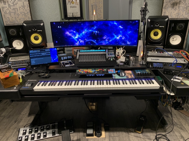

      • #153853
        donrwatters
          I have this exact setup.  I use my Studio 192 as the main interface (probably swapping out for an Avid MTRX Studio as soon as it’s available). I use the ADAT I/O from and to both to chain them together, so that I can send audio from my DAW through the 192 out ADAT, into the H9000, and back from the H9000 ADAT out to the 192, into the DAW.  I’ve setup the H9000 as an external hardware using Pipeline XT, exposing each pair of stereo outs through ADAT.
          See the right side of this image…If you have other questions, I’m happy to help.

                      • #153856
                        joeydego
                          Man, thank you!!! So you basically get 8 channels of Eventide this way at 48k, yes? 2 optical cables and I’m golden?
                        • #153859
                          donrwatters
                            Yes, that’s it.
                          • #153860
                            donrwatters
                              joeydego wrote:
                              That’s an astounding similarity! 🙂

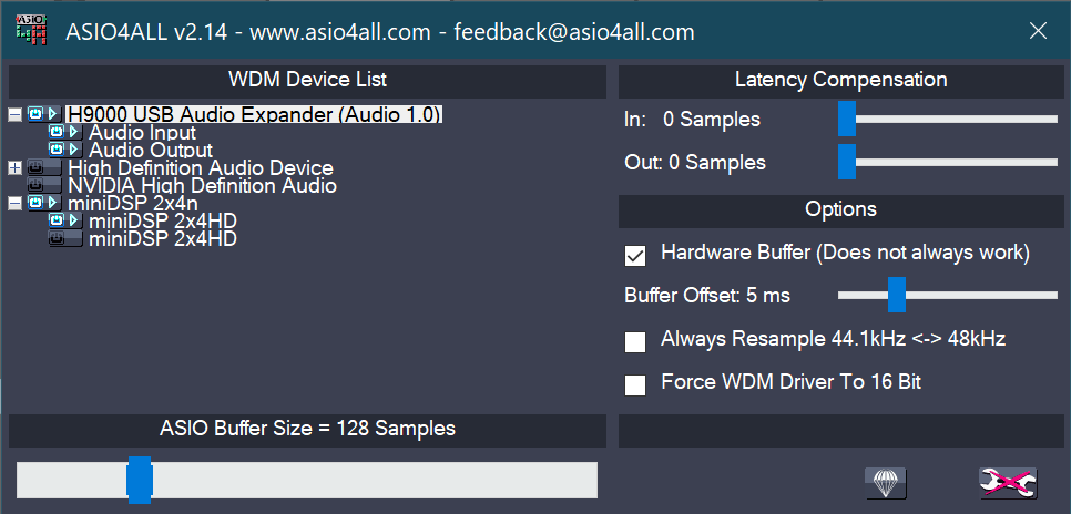

                                              • #155174
                                                tpluta
                                                  I tried out ASIO4ALL with the H9000 in a couple of different setups and had some mixed results. For example, I tried out the H9000 by itself and as part of an aggregate device with my USB DAC, and I had some good results with both setups even at very low buffer sizes. However, I tried aggregating my H9000 with a different USB audio interface and I kept getting some pretty bad dropouts and crackles no matter how I configured the buffer settings.
                                                  I attached the ASIO4ALL settings that were giving me good results with my DAC. If you get crackles or dropouts, try increasing the ASIO Buffer Size and/or Buffer Offset. Otherwise, you can try to get lower latency by decreasing either of those settings. Also, keep in mind that each device you add to the ASIO4ALL aggregate has its own buffer settings. I suggest enabling and configuring each device separately before trying to put them together.
